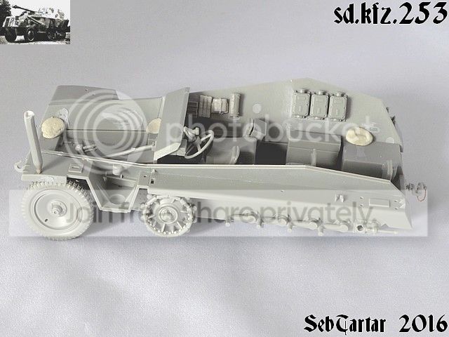

Here is the progress so far:

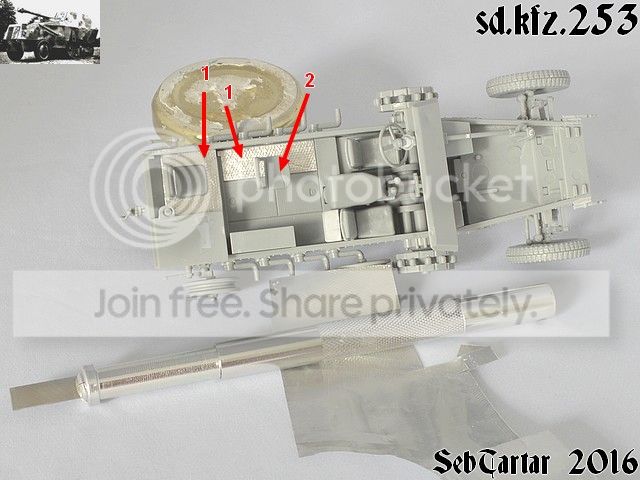

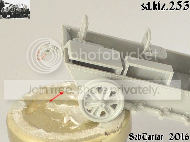

Lower hull
The sides and the drive sprockets are not glued. I will paint separately the elements from the undercarriage.
The tow hook supports were thick. I replaced them with alu foil.

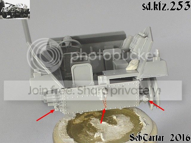

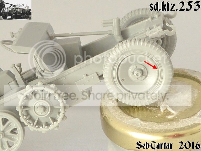

I added the inflating valve to the wheels and 2 bolts on each "pad" of the drive sprockets.
The bars that were used for adjusting the tension on the idlers were drilled out and the tow hook was thinned down a bit and I added a chain made of copper wire.
Interior
1. The floor was imporved with lu fil on which I rolled the grove part of my knife.
2. I did not follow the instruction for positioning the seat but used an sd.kfz. 250/5 as a reference.

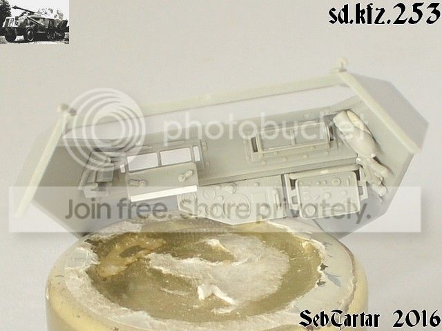

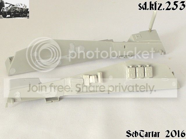

Roof

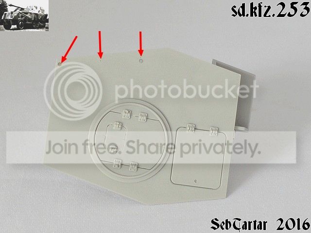

Outside:
I will not glue the antenna rack but drilled its screw holes.

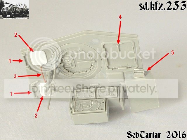

Inside:
1. The opening system for the episcopes was taken from the spare box
2. The pads were forgotten by Dragon. I will put some green stuff to imorve their aspect.
3. On the pictures of the real thing, a handle can clearly be seen.
4.I redid the handle on the roof hatch.
5. On the picture, a spare episcope box is visible.
I still need to put some handles on the radios and their wiring.
Driver compartment
On the driver side the shutter will be partly open and the episcope is put downwards. I added its locking system and a metal bar.
I opened the small windows with a blade and will place some clear plastic sheet instead.
I will not detail this area any further as very little will be seen once everything is closed (even with a LED inside).

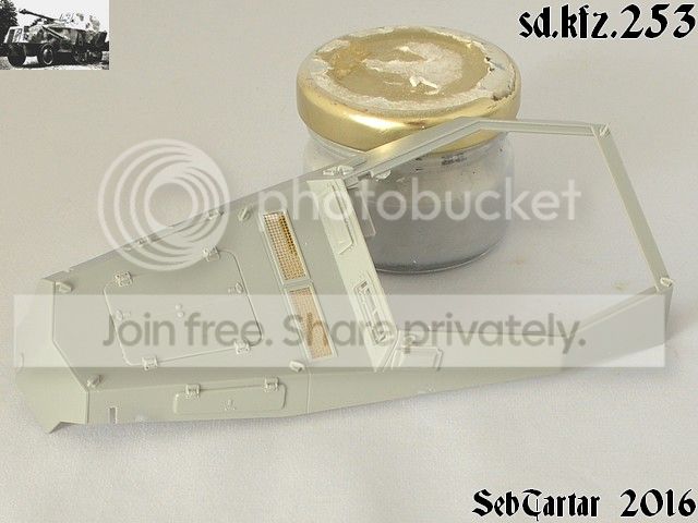

I only replaced the proposed plastic mesh with some spare PE (Tiger II engine grids)

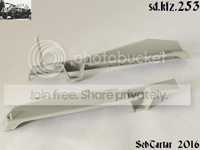

The OOb part in the background and the modified part in the foreground.

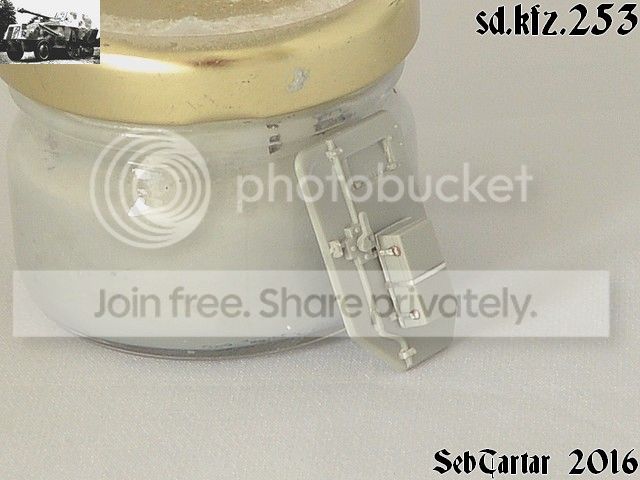

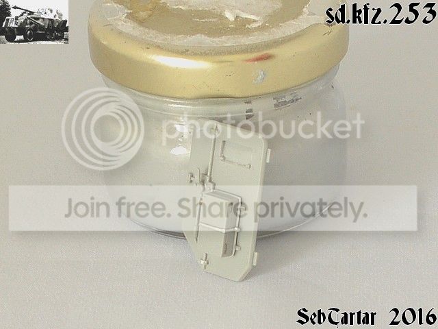

Rear door:
I improved the Verbadkasten (first aid box) fitting system.
The first aid box itself was imporved with the addition of locks and hinges.
I still have to glue the episcope on.

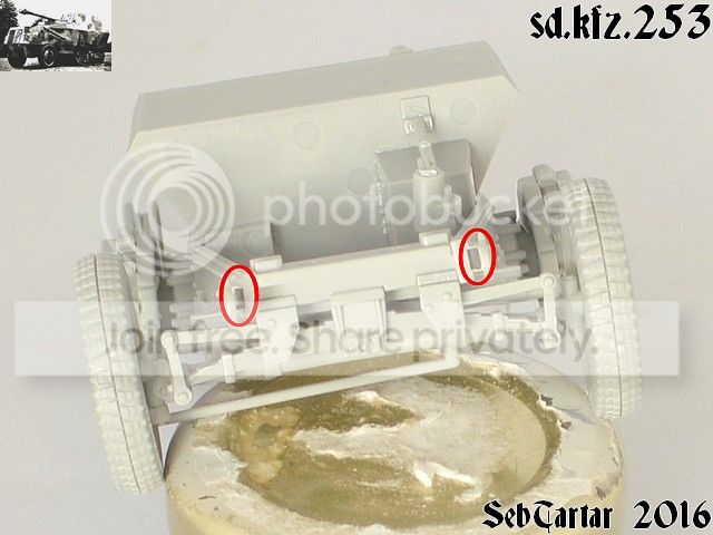

Inside:

They demand a lot of work as the vehicle which inspired this build has rounded mudguards with a rib running along the bottom.
